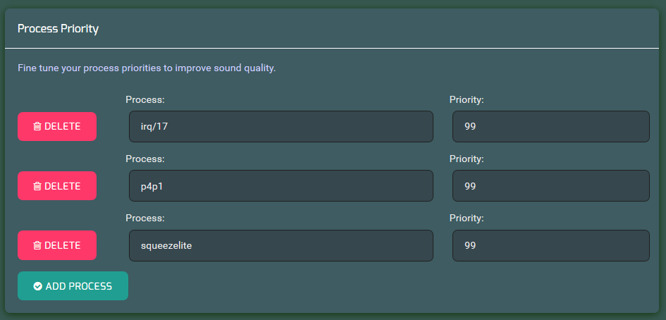

You are ready to start tweaking the priority once you have identified which processes to target. In our example, let’s say we have identified 3 process worth tweaking, they are:
- USB: under the command of irq/17-xhci
- Ethernet: under the command of irq/10-prp2
- Squeezelite: under the command of squeezelite
Click the Add Process button 3 times to add 3 entries. Each entry consist of the following fields:
- Process name: This is the command name of the process, e.g. irq/17 (now that / is a special character and you’d need to escape it with a \, so for irq/17 you enter it as irq\/17)
- Prio: This is the new priority level for the process. It’s a number from 1-99 (Higher number = higher priority)
- Remove: Click this button to remove the entry
Enter a unique part of process name (command column) in the process name field. i.e. don’t use text like irq because there are multiple IRQ processes running. Be more specific, like irq/17. The second field defines the priority level for the process (a number from 1 to 99, with 99 being realtime). Here is an example:Squeezelite and xhci are running in real time, while Ethernet is not, but still at a relatively high numer. Click the Save Changes button to apply the settings (these setting will remain active after a reboot).
Experiment by modifying the numbers and see if it changes the sound quality in any meaningful way. Remember this rule - a higher number isn’t always better, the idea is to strike a good scheulding policy, not run everything as needed, when needed.

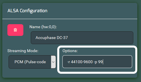

![Change Priority](https://www.snakeoil-os.net/media/blogs/Manual-old/WebApp/_evocache/musicplayers_-_player_options.png/fit-1280x720.png?mtime=1568103197)
Not that there’s anything wrong with this, as the main process still runs in rt, but what’s more important, is to specify the output thread to be real time as well. You can do so with the special options in the software player, like so:The magic is in the -p argument.
-p <priority> Set real time priority of output thread (1-99)
What that option does is to set the output thread to real time priority1. The memory will be locked too which means it will not be swapped out (reducing latency to minimum).

1. For Squeezelite -p option to work, you’d need firmware 0.1.4-prelease-20160515 or later. Check the forums for the latest version.
